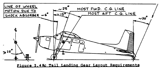

Re: Which tail-draggers are least prone to ground-looping?
From Roskam:
Thinking out loud...
Some of the main problems with controlling a ground loop at low speed appear to be differential brake action and the overturning moment lifting the inside main landing gear off the ground. Thoughts?
So if the wheels are further apart, then both differential braking and the weight on the inside wheel are improved, making the loop much easier to arrest or control - effectively delaying the "point of no return" until the plane is deeper into the loop.
However, I think that benefit has little to do with the unbalanced forces causing the loop in the first place. Going out on a limb here!
