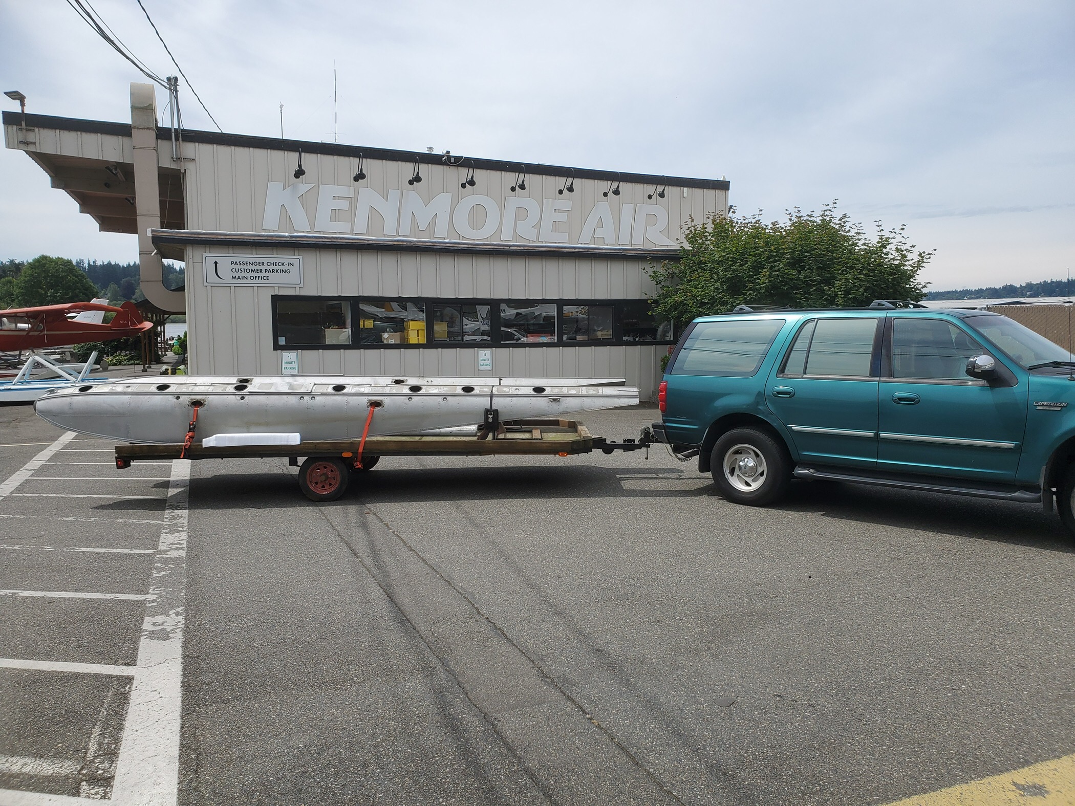

Some assembly required. While the floats are about the last major assembly needed, today was the best day to get them. 2960s in good shape. Paint scheduled for next week. Engine supposed to ship on Tues.

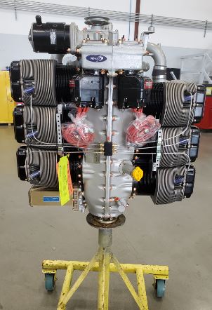

Seems like taking forever but finally some visible progress.
Rebuilt XP470 engine just arrived.

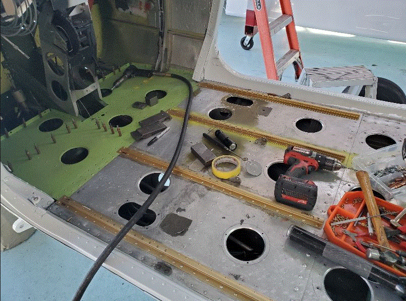

There is a very fine line between brave and stupid. :)
But progress. The seat tracks (ridiculously expensive for a wear item) are now in and the last few rivets on the floor boards.

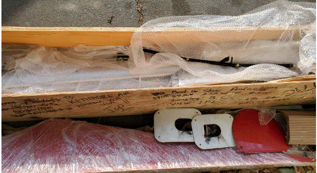

Yes the floats are off a 180 but the are just the barrels. The rigging is in a box, now next to the 182 rigging. Thanks for the tip on the 182 assembly differences.
Yes the build will prove interesting. I am optimistic that Kenmore has the experience to do it right. Engine should hang next week.

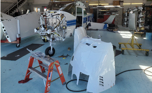

Now we are making progress. Engine mount installed and new lower cowl fitted. Note engine is in the photo, far right. It should be mounted today. While we have 2 mixture control cables, both are broken. $250.
Also received the STCs and all the paperwork from SPW for the SPW float kit, engine mount, and float install, along with install instruction. Have to credit SPW (Paul), class act. Air Plains wanted $2500 to "transfer" the IO-550 STC, Paul asked only that we pay the FedEx to ship it all.
